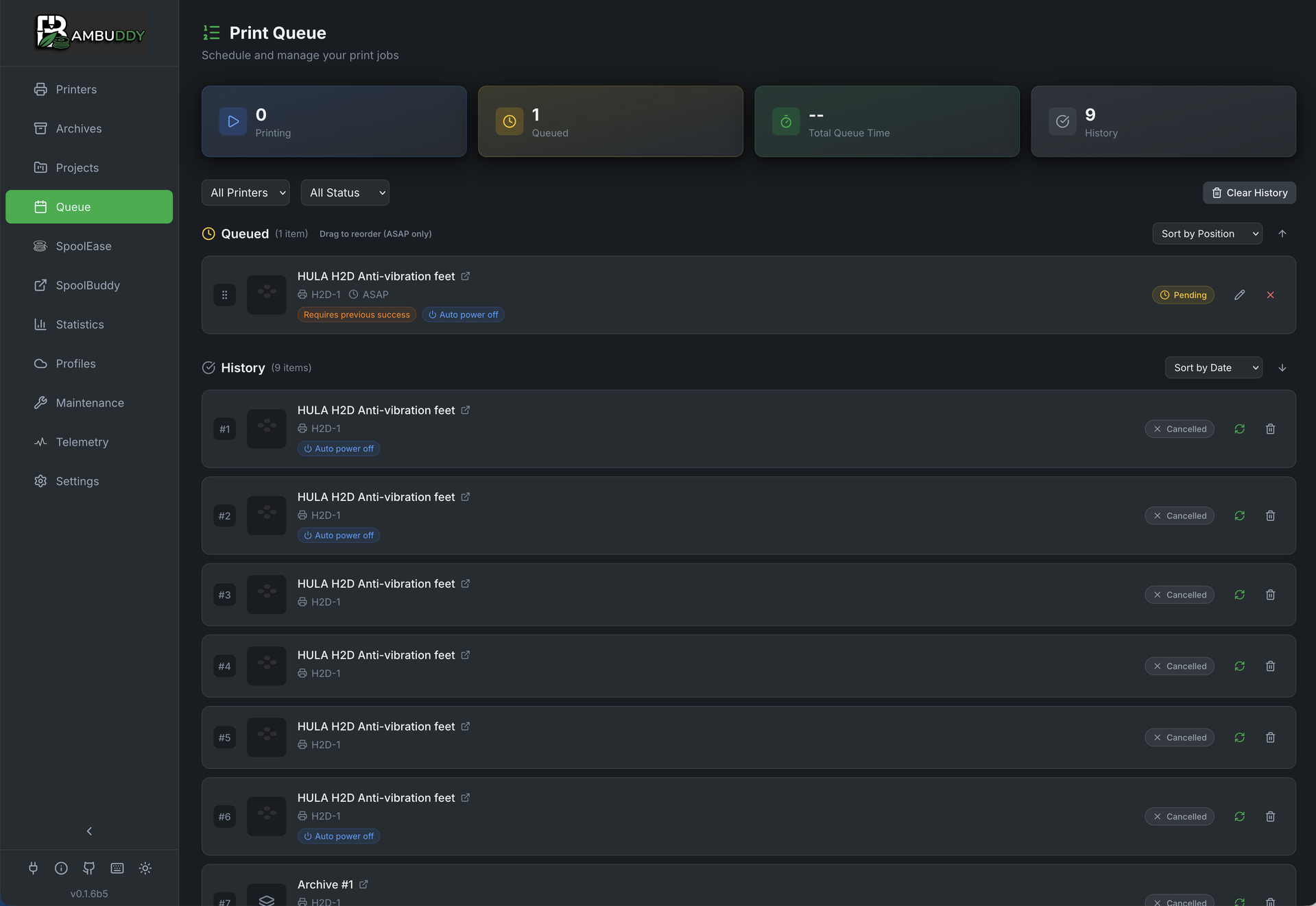

The print queue lets you:
  • Queue prints from your archive
  • Order with drag-and-drop
  • Schedule specific start times
  • Automate with smart plug integration
  • Track queue progress

Queue Status
State Icon Description
Queued Waiting in queue
Scheduled Waiting for scheduled time
Starting Sending to printer
Printing Currently printing
Completed Successfully finished
Failed Print failed
Cancelled Manually removed
